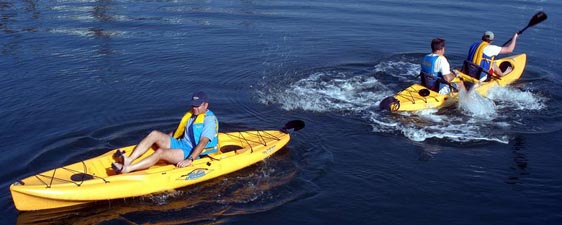

The
Hobie MirageDrive propels the boat easily and smoothly, and reaches hull speed
with minimal effort. It also generates significant static thrust. In a "tug-of-war"
between a single Hobie Mirage and a tandem paddled kayak, the Hobie Mirage won
hands-down (pun intended). Check out the video below!

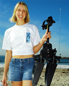

>>The
MirageDrive fins fold up next to the hull for beaching and in shallow water by
simply putting one foot forward.
