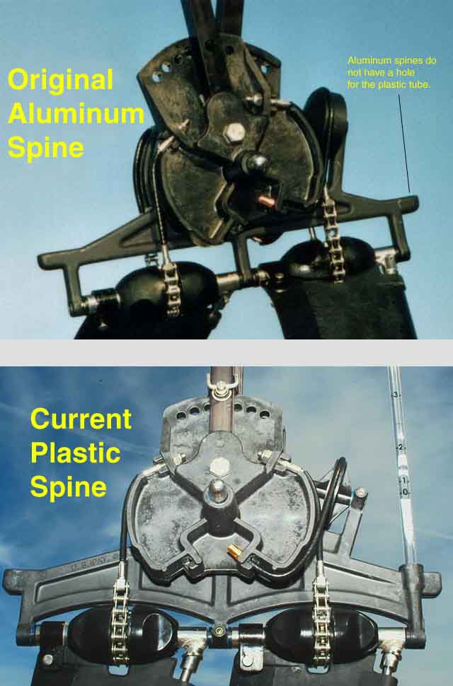

Press
the bottom of the clear plastic tube into the hole on the top front of the spine
of the Hobie Mirage Drive. Be sure to spin the tube so the numbers are facing
aft.
| Note:
The speedometer can only be used with later Mirage Drives that have the plastic
spine as opposed to the cast aluminum
spine. We started shipping these new plastic spines in August of 2001. |
