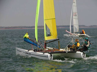

End of the pole (w/ sock):
Advantages
* uses bag/sock so is lighter than new fiberglass tube
* spin tack is permanently attached to end of pole so no extra tack line to
pull tack of spin out to end of pole
* less expensive
* able to hold spinnaker longer at leeward mark and actually take down spin
while rounding mark and heading upwind
Disadvantages
* more windage having sock all the way out to end of pole
* if something happens to spin it's difficult to fix on the water (can't reach end of pole from bow of boat)
The above snuffer was an optional feature in the Tiger and cost $390. It included the bag, bowl and all spinnaker hardware (sheets, halyards, bridles, etc.)
Many North American Tiger sailors have gone with different style socks other than the blue stock sock that comes standard with the spinnaker kit simply because the fabric is not very giving and it tends to be smaller in width then other socks.
Note: Skip Elliott makes a great sock.
Approximate weight of this snuffer system is 2.0 lbs.
You can order this directly through your Hobie Dealer now.
It is both Hobie class legal and F18 legal.

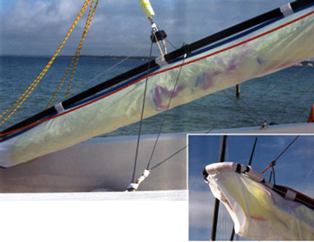

Mid Pole (w/ fiberglass tube):
Advantages
* if something does happen to spinnaker while on the water you can reach it to fix
* does not absorb water
Disadvantages
* heavy (6 lbs.)
* must take down spin while sailing downwind
* need separate spin tack line or spin halyard attached to spin tack line to get spin tack to end of pole when launching * expensive
* 3 holes/patches needed in spinnaker instead of 2 with end of pole snuffer.
The Mid pole snuffer system is also an optional feature on the Tiger. Currently is not widely used in North America, but with a shipment expected for delivery in early September you might be seeing more of these around the race courses. Approximate weight is 6 lbs and it is both Hobie class legal and F18 legal. It will have an estimated price tag of $500, but please keep in mind this price is only an approximation. A final price will be posted as soon as it is made available. Hobie dealers should be able to start ordering the mid pole snuffer by late September 2002.

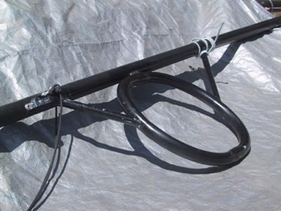

There are many other snuffer options available which vary on the systems mentioned above. One of which uses a hoop (fiberglass or aluminum) that is attached to the pole in some fashion just in front of the bridle wires (mid-pole) and uses a bag that either stops at the front crossbar or continues on under the tramp depending on how many patches (2 or 3) you want to put in your spinnaker. An example of someone using this system is Jeff Alter who has welded the aluminum hoop that Hobie Cat provides to the side of his spinnaker pole and uses a bag that stops at the front of the crossbar. Another system uses an aluminum bowl which fits above the spin pole at the bridle wires which basically takes up the triangle space between the spinnaker pole and the bridle wires. It uses a bag that attaches to the hoop and starts off on top of the spinnaker pole and as it goes back, it gradually works its way to the side of the pole and then under the pole as it reaches the crossbar (no pictures available). Only time will tell which system will be the best, but I think some configuration of the mid-pole system will eventually work the best. For reference, Hobie Tiger Class rule 12.2 on bowsprits
